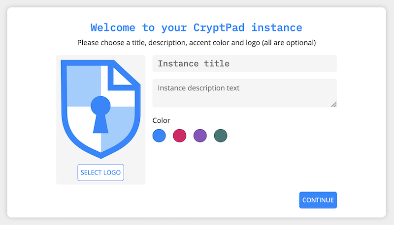

Setup your instance¶

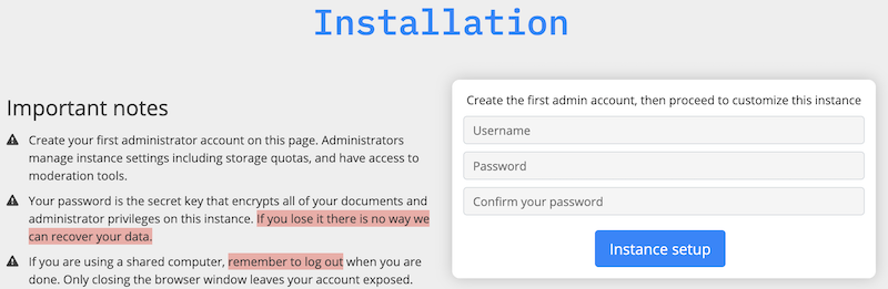

Once CryptPad is installed, use the URL with the token generated when you ran the server for the first time to start the onboarding workflow.
First, create your administrator account.
Then you can add a logo of your choice (200KB maximum size), change the instance title, description and choose an accent color.

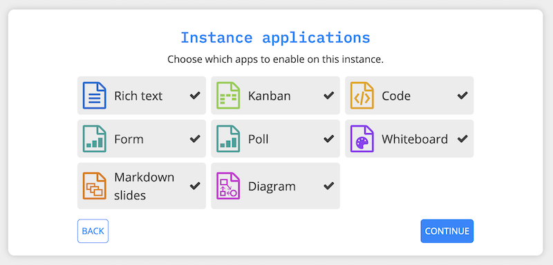

The next step is about chosing the applications to enable (all by default).

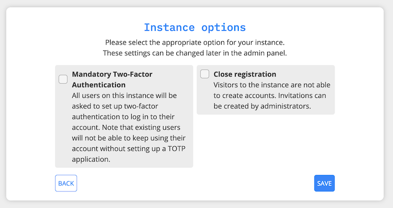

The last step let you enable two options:
Mandatory Two-Factor Authentication
Close registration
All these options can be changed later on in the administration panel.
